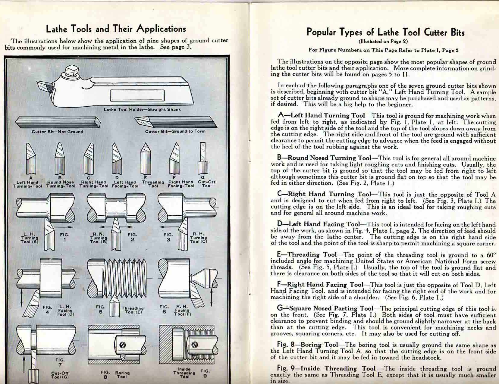

The illustrations on the opposite page show the most popular shapes of ground lathe tool cutter bits and their application. More complete information on grinding the cutter bits will be found on pages 5 to II.
In each of the following paragraphs one of the seven ground cutter bits shown is described, beginning with cutter bit “A,” Left Hand Turning Tool. A sample set of cutter bits already ground to shape may be purchased and used as patterns* if desired. This will be a big help to the beginner.
A—Left Hand Turning Tool—This tool is ground for machining work when fed from left to right, as indicated by Fig. I, Plate I, at left. The cutting edge is on the right side of the tool and the top of the tool slopes down away from the cutting edge. The right side and front of the tool are ground with sufficient clearance to permit the cutting edge to advance when the feed is engaged without the heel of the tool rubbing against the work.
B—Round Nosed Turning Tool —This tool is for general all around machine work and is used for taking light roughing cuts and finishing cuts. Usually, the top of the cutter bit is ground so that the tool may be fed from right to left although sometimes this cutter bit is ground flat on top so that the tool may be fed in either direction. (See Fig. 2, Plate I.)
C—Right Hand Turning Tool—This tool is just the opposite of Tool A and is designed to cut when fed from right to left. (See Fig. 3, Plate I.) The cutting edge is on the left side. This is an ideal tool for taking roughing cuts and for general all around machine work.
D—Left Hand Facing Tool—This tool is intended for facing on the left hand side of the work, as shown in Fig. 4, Plate I, page 2. The direction of feed should be away from the lathe center. The cutting edge is on the right hand side of the tool and the point of the tool is sharp to permit machining a square corner.
E—Threading Tool—The point of the threading tool is ground to a 60° included angle for machining United States or American National Form screw threads. (See Fig. 5, Plate I.) Usually, the top of the tool is ground flat and there is clearance on both sides of the tool so that it will cut on both sides.
F—Right Hand Facing Tool—This tool is just the opposite of Tool D. Left Hand Facing Tool, and is intended for facing the right end of the work and for machining the right side of a shoulder. (See Fig. 6, Plate I.)
G—Square Nosed Parting Tool—The principal cutting edge of this tool is on the front. (See Fig. 7, Plate 1.) Both sides of tool must have sufficient clearance to prevent binding and should be ground slightly narrower at the back than at the cutting edge. This tool is convenient for machining necks and grooves, squaring corners, etc. It may also be used for cutting off.

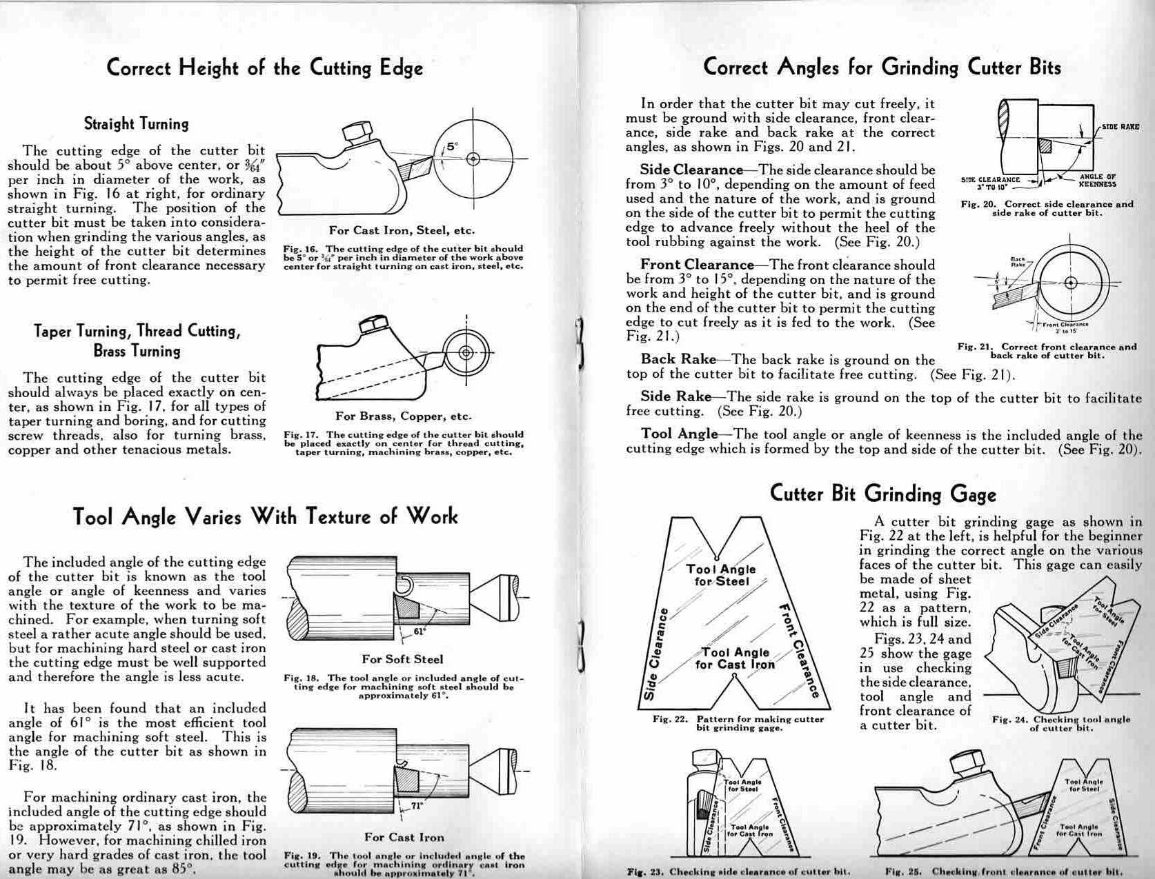

The cutting edge of the cutter bit should be about 5° above center, or per inch in diameter of the work, as shown in Fig. 16 at right, for ordinary straight turning. The position of the cutter bit must be taken into consideration when grinding the various angles, as the height of the cutter bit determines the amount of front clearance necessary to permit free cutting.
For Cast Iron, Steel, etc.
Fig. 16. The cutting edge of the cutter bit should be 5° or per inch in diameter of the work above center for straight turning on cast iron, steel, etc.
Taper Turning, Thread Cutting, Brass Turning
The cutting edge of the cutter bit should always be placed exactly on center, as shown in Fig. 17. for all types of taper turning and boring, and for cutting screw threads, also for turning brass, copper and other tenacious metals.
Tool Angle Varies With Texture of Work
The included angle of the cutting edge of the cutter bit is known as the tool angle or angle of keenness and varies with the texture of the work to be machined. For example, when turning soft steel a rather acute angle should be used, but for machining hard steel or cast iron the cutting edge must be well supported and therefore the angle is less acute.
It has been found that an included angle of 61° is the most efficient tool angle for machining soft steel. This is the angle of the cutter bit as shown in
Fig. 18.
For machining ordinary cast iron, the included angle of the cutting edge should be approximately 71°, as shown in Fig. 19. However, for machining chilled iron or very hard grades of cast iron, the tool angle may be as great as 85°,
Fig. 18. The tool angle or included angle of cutting edge for machining soft steel should be approximately 61°.
For Cast Iron
Fig. 19. The tool angle or Included angle of the cutting cdKc f,,r machining ordinary rant iron should be approximately 71 .
For Brass, Copper, etc.
Fig. 17. The cutting edge of the cutter bit should be placed exactly on center for thread cutting, taper turning, machining brass, copper, etc.
Correct Angles for Grinding Cutter Bits
In order that the cutter bit may cut freely, it must be ground with side clearance, front clearance, side rake and back rake at the correct angles, as shown in Figs. 20 and 21.
Side Clearance—The side clearance should be from 3° to 10°, depending on the amount of feed used and the nature of the work, and is ground on the side of the cutter bit to permit the cutting edge to advance freely without the heel of the tool rubbing against the work. (See Fig. 20.)
Front Clearance—The front clearance should be from 3° to I 5°, depending on the nature of the work and height of the cutter bit, and is ground on the end of the cutter bit to permit the cutting edge to cut freely as it is fed to the work. (See
Fig. 21.)
Fig. 20. Correct side clearance and side rake of cutter bit.
Fig. 21. Correct front clearance and back rake of cutter bit.
Back Rake—The back rake is ground on the top of the cutter bit to facilitate free cutting. (See Fig. 21).
Side Rake—The side rake is ground on the top of the cutter bit to facilitate free cutting. (See Fig. 20.)
Tool Angl e—The tool angle or angle of keenness is the included angle of the cutting edge which is formed by the top and side of the cutter bit. (See Fig. 20).
Cutter Bit Grinding Gage
Fig. 22. Pattern for making cutter bit grinding gage.
A cutter bit grinding gage as shown in Fig. 22 at the left, is helpful for the beginner in grinding the correct angle on the various faces of the cutter bit. This gage can easily be made of sheet metal, using Fig.
22 as a pattern, which is full size.

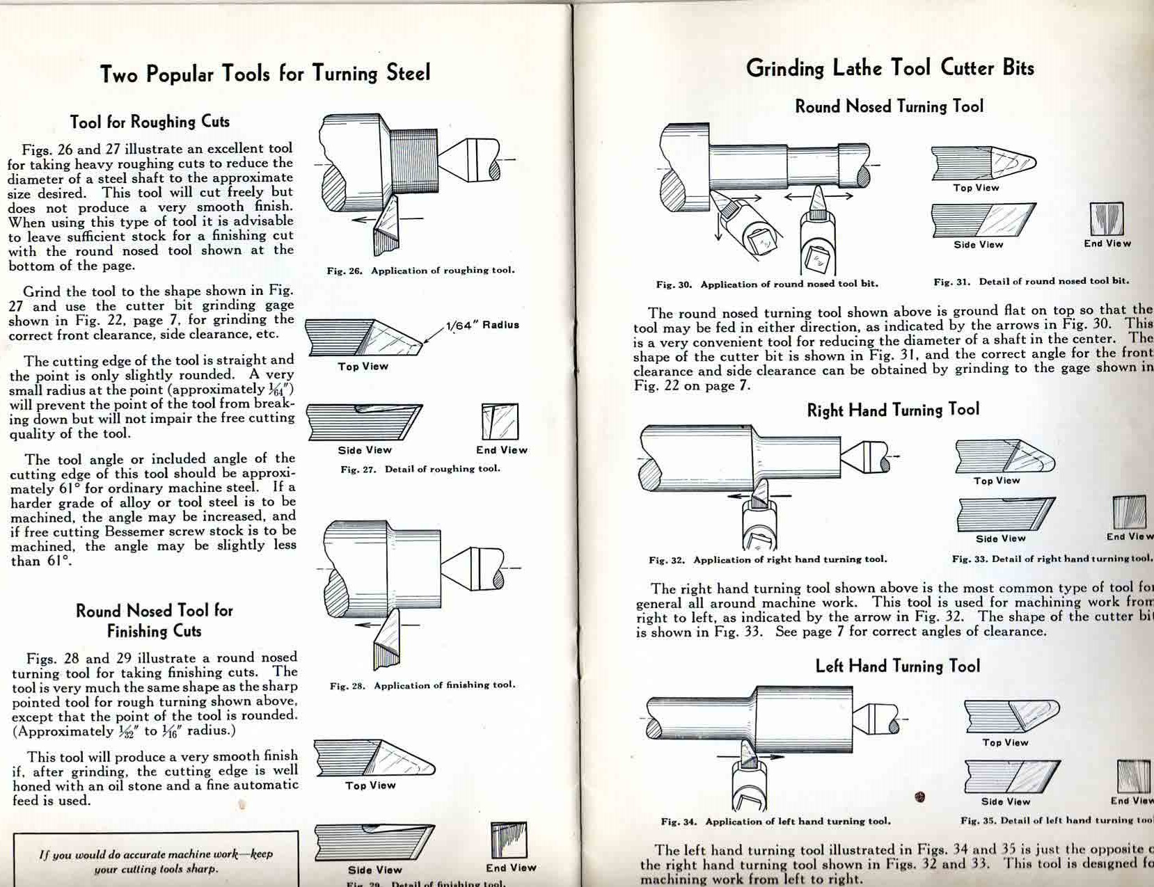

Figs. 26 and 27 illustrate an excellent tool for taking heavy roughing cuts to reduce the diameter of a steel shaft to the approximate size desired. This tool will cut freely but does not produce a very smooth finish. When using this type of tool it is advisable to leave sufficient stock for a finishing cut with the round nosed tool shown at the bottom of the page.
Grind the tool to the shape shown in Fig. 27 and use the cutter bit grinding gage shown in Fig. 22, page 7, for grinding the correct front clearance, side clearance, etc.
The cutting edge of the tool is straight and the point is only slightly rounded. A very small radius at the point (approximately \i\) will prevent the point of the tool from breaking down but will not impair the free cutting quality of the tool.
The tool angle or included angle of the cutting edge of this tool should be approximately 61° for ordinary machine steel. If a harder grade of alloy or tool steel is to be machined, the angle may be increased, and if free cutting Bessemer screw stock is to be machined, the angle may be slightly less than 61°.
Round Nosed Tool for Finishing Cuts
Figs. 28 and 29 illustrate a round nosed turning tool for taking finishing cuts. The tool is very much the same shape as the sharp pointed tool for rough turning shown above, except that the point of the tool is rounded. (Approximately to radius.)
This tool will produce a very smooth finish if. after grinding, the cutting edge is well honed with an oil stone and a fine automatic feed is used.
Fig. 31. Detail of round noned tool bit.
The round nosed turning tool shown above is ground flat on top so that the tool may be fed in either direction, as indicated by the arrows in Fig. 30. This is a very convenient tool for reducing the diameter of a shaft in the center. The shape of the cutter bit is shown in Fig. 31, and the correct angle for the front clearance and side clearance can be obtained by grinding to the gage shown in Fig. 22 on page 7.
Fig. 33. Detail of right hand turning tool.
The right hand turning tool shown above is the most common type of tool foi general all around machine work. This tool is used for machining work froit right to left, as indicated by the arrow in Fig. 32. The shape of the cutter bil is shown in Fig. 33. See page 7 for correct angles of clearance.
