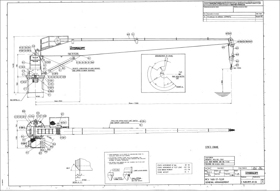

A According To Daewoo gommemTs 90-05.07 62.
PIPES FOR UPPER HOIST LIMIT SWITCH AND REMOTE LUBRICATION _______________
DETAIL A, 1:1
1. CRANE FOUNDATION TO BE WELDEO TO SUBSTRUCTURE PRIOR TO INSTALLING CRANE WITH SLEW BEARING.
2. SLEW BEARING SUPPORT FLANGE HAS TO BE MEASURED FOR FLATNESS AFTER ALL WELDING HAS BEEN COMPLETED AND STRUCTURE RETURNEO TO NORMAL TEMPERATURE.
3. FOR OPTIMAL SLEW BEARING LIFE THE FLATNESS HAS TO BE KEPT WITHIN GIVEN TOLERANCES.
0,190
SLEW BEARING SUPFDRT FLANGE
"-3L. CRANE w/SLEW BEARING
TORQUE = 62Kpm USE SPECIFIED BOLTS AND WASHERS
CUSTOMER:
DAEWOO HULL NO.: 5501
STATIC KIPMOMENT AT SWL. : 97 TM
STATIC KIPMOMENT AT TEST LOAD :117 TM
SLEW BRAKE MOMENT •• 21.1 TM
CRANE WEIGHT >8 T
A/S NOR-MARINE JOB NO.:71/90 MACHINE NO. K2S25-1890

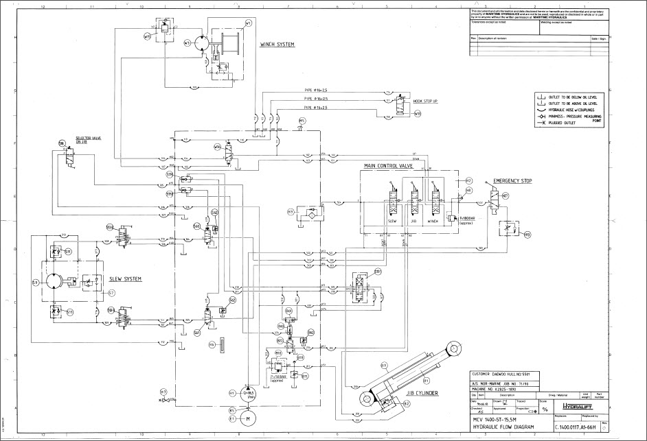

CRANE TYPE : MCV 1400-5T-15,5M MACHINE NO.: K2825-1890
(B) BUILDER SUPPLY (DAEWOO)
?0S. NO. ART.NO. DESCRIPTION QTY. SPECIFICATION
H MAIN SYSTEM
HI 14431 MAIN PUMP 1 PA 1911 R3B26A
H2 MAIN CONTROL VALVE 1 VB 1107 NDN P-175, LH ASSY
H3 11250 HYDR. OIL FILTER 1 TTF-170
H4 11259 FILTER ELEMENT FOR H3 1 TXX4-10
H5 15058 HYDR. OIL FILLING ARR. 1 EF4-50HY 2" BSP
H6 15049 . HYDR. OIL LEVEL INDICATOR 1 UC-FL-213
H7 | DRAIN VALVE 1 51-1" w/PLUG
H8 11993 MINIMESS PRESSURE POINT 1 ST-04, R 1/4" BSP 316
Hll RUBBER SEAL FOR PUMP 1 2mm NEOPRENE
H12 STUD BOLTS FOR PUMP w/NUT 4 M12x30, DIN 938-8.8
H13 15061 INITIAL SERVO PRESS .VALVE 1 VDR R16-C2
H27 14403 EMERGENCY STOP VALVE 1 SSV 09x9L Hy
(P-K)PK-1400-66
SLEW SYSTEM
SLEW RING 1
BOLTS FOR SLEW RING, 54
OUTER RING. TYPE 1.
BOLTS FOR SLEW RING, 6
OUTER RING. TYPE 2.
BOLTS FOR SLEW RIMS, 60
INNER RING
NUT F/BOLT IN SLEW RING 54
WASHER, HARDENED 174
SLEW GEAR BOX 1
BOLT FOR GEARBOX MOUNT. 16
HYDR. SLEW MOTOR 1
STUDBOLT FOR SLEWMOTOR/ GEAR w/NUT 4
SLEW RESTRICTOR VALVE 2
SLEW STOP VALVE 1
SLEW STOP VALVE 1
SLEW STOP VALVE 1
RED CAP F/SLEW RING BOLT 54 RED CAP F/MOUNTING BOLTS SLEWSEAR 16
SLEW STOP ARRANGEMENT 1
PILOT OPER. CHECK VALVE SLEW LEFT 1
PILOT OPER. CHECK VALVE SLEW RIGHT 1
JIB ANGLE OVERRIDE VALVE 1 SLEW STOP VALVE 1
SLEW STOP VALVE 1
BLEEDER VALVE 2
062.30.1400.Oil.41.1504 UNBRAKO M20xl50, U-130 DIN 912-12.9 UNBRAKO M20xl00, U-130 DIN 912-12.9 UNBRAKO M20xl50, U-130 DIN 912-12.9 M20, DIN 6330-10 039/021 x 6
S385 (m=12 z=12 c=0,5 b=88) 1=146,8 SAE C UNBRAKO Ml6x50, DIN 912-12.9 MC 2208 C5B25D
Ml2x30, DIN 938-8.8 VDR R16-C2 VB 1006N w/HPOO DSV 06x26L DSV 06x26L DBI DOT NO.:50
DBI DOT NO. :41 DRW.NO.:
RH 2
RH 2
TZ3-1 / HL 06.297 SSV 09x31S SSV 09x31S FT 1251/2-01-1/4"
(P-K)PK-1400-66
