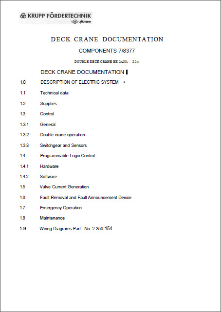

DECK CRANE DOCUMENTATION I
1.0 DESCRIPTION OF ELECTRIC SYSTEM
1.1 Technical data
1.2 Supplies
1.3 Control
1.3.1 General
1.3.2 Double crane operation
1.3.3 Switchgear and sensors
1.4 Programmable logic control
1.4.1 Hardware
1.4.2 Software
1.5 Valve Current Generation
1.6 Fault Removal and Fault Announcement Device
1.7_ Emergency Operation
1.8 ftfte'ntenance

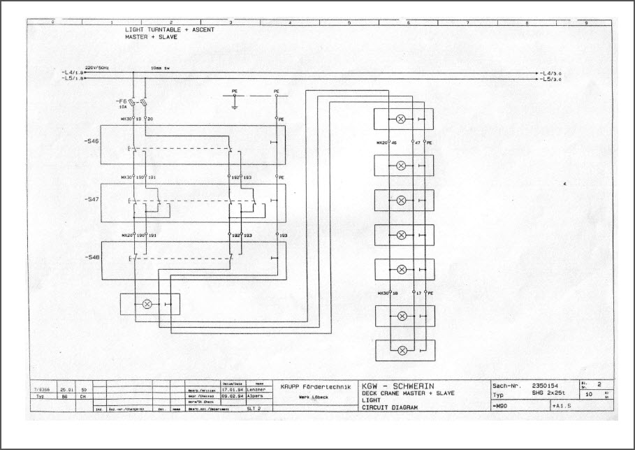

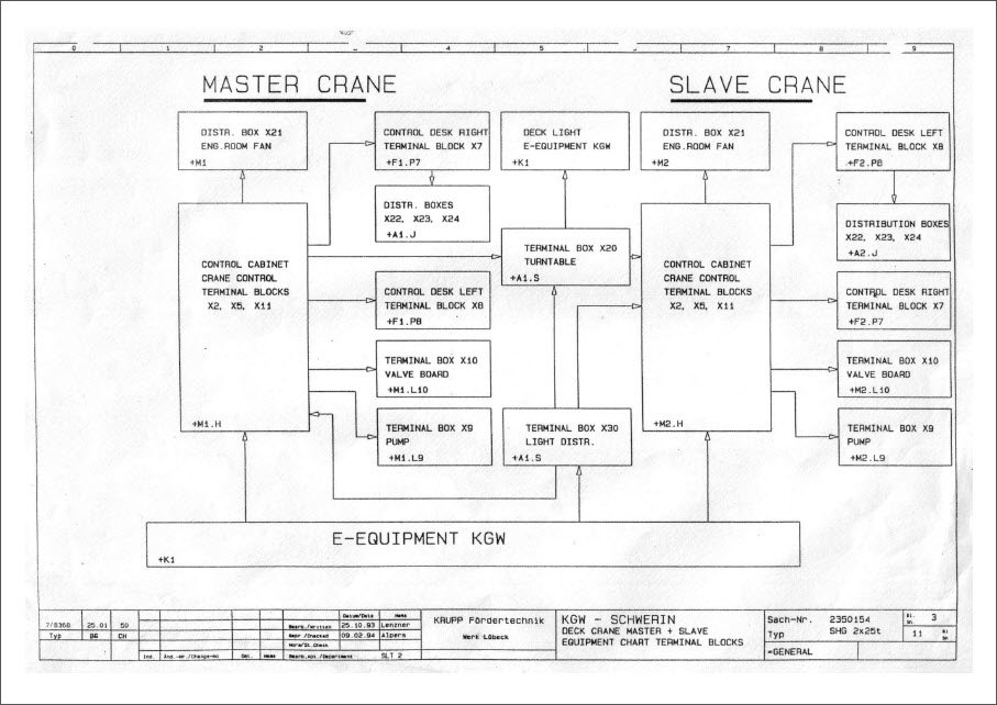

1.9 Wiring Diagrams Part-No. 2 350 154
2.0 SPARE PARTS LISTS - ELECTRIC SYSTEM
DECK CRANE DOCUMENTATION II
3.0 DESCRIPTION OF HYDRAULIC SYSTEM WITH DIAGRAM
3.1 SPARE PARTS LISTS - HYDR. SYSTEM WITH DIAGRAM
3.2 SPARE PARTS - HYDR. SYSTEM - COMPONENTS
3.3 SPARE PARTS DOCUMENTS -PURCHASED PARTS

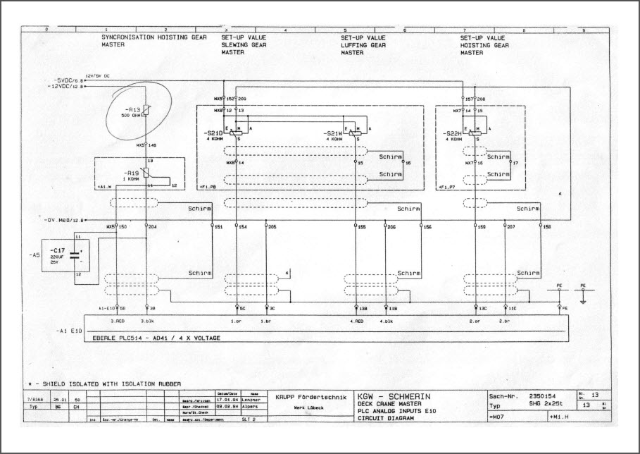

The crane is controlled by a Programmable Logic Controller (PLC). In the PLC digital input signals of the switchgear (contactor contacts, master switch contacts, limit switches etc.) and the analogue values of the speed setting transmitters control lever potentialme-ters) and of the sensors (pressure and temperature transformers) are worked off according to the software and the respective outlets of the PLC which switch on the signal lamps, contactors, or solenoid valves are energized. The PLC outlets give the calculated valve current value for adjustment of the pumps as a data record to the valve current control card.
Control voltage is 24 V D.C. , it is generated with the
3-phase current network bridge = M02-U1.
In addition a D.C. voltage of ±5 V is needed for feeding the reference value potentialmeters in the masters switched and the valve current control card. This D.C. voltage is generated with the electronic power supply M02-U2.

Besides directional contacts, the master switches are equipped with potentiometers.
The potentiometers are supplied with 5 V, output voltage changes 3CC. to the angle of deflection from 0 to 5 V (0 v in zero position, 5 V at maximum deflection) .
