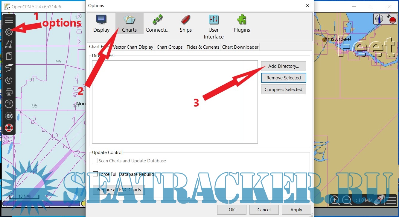

today i want to share with you my method to install OpenCPN then how to add the world charts, all that to have an emulator of ECDIS and that help you to know about ports and navigational zones and everything you need before creating your reals routes. so, let get started.
1. download the OpenCPN from the official website, then install it.
- official OpenCPN's website ( https://opencpn.org/OpenCPN/inf...loadopencpn.html ). (44 MB)
2. now, you need to download the World charts.
- google drive link ( https://drive.google.com/file/d...43Cklnc9Oib/view ). (1.72 GB).
- then extract the folder using Winrar or 7zip, (the name of the folder is "CM93 11.20.15 Mariners Guide").
3. after openCPN is installed, open it and click on "options'' then click on "charts", now click on "add Directory" and select the extract folder of World Charts. and finally click on OK. (like the pic below)
- now, congratulation, you have all the world chart in your computer, you can now create and edit routes like you want.

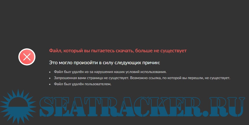

81506Password: MarinersGuide
