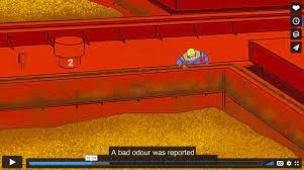

Upon arrival at the discharge port, the hold and manhole seals were inspected and found to be intact. Hold no.'s 2, 3 and 5 were approved for discharge. However, hold no.'s 1 and 4 were rejected. A bad odour was reported at the forward end of both hatchways.
The surface of the cargo stow in both of the rejected cargo holds was found to be locally mouldy, discoloured and caked, with temperatures in the affected areas measured up to 63°C. The quantity of damaged cargo was estimated to be about 10 to 12 MT in each hold.
During the pre-discharge inspection of the cargo, examination of the hatch cover panel cross joints of hold no.'s 1 and 4 revealed that a substantial amount of wetted maize kernels and associated residue were present in the drain channels above and between the cross joint sealing. It was apparent that the panel cross joints had not been cleaned in preparation of the hatch covers being closed at the load port. The hatch coaming drain channels were also found to contain cargo residue, which had either not been removed after loading or had collected in the channels through water drainage from the cross joints.
