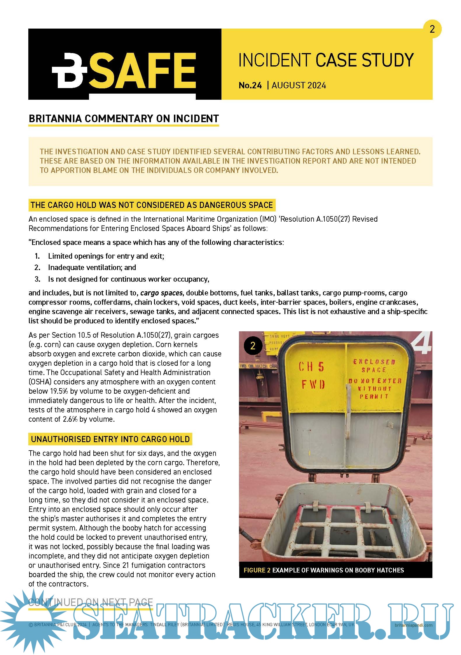

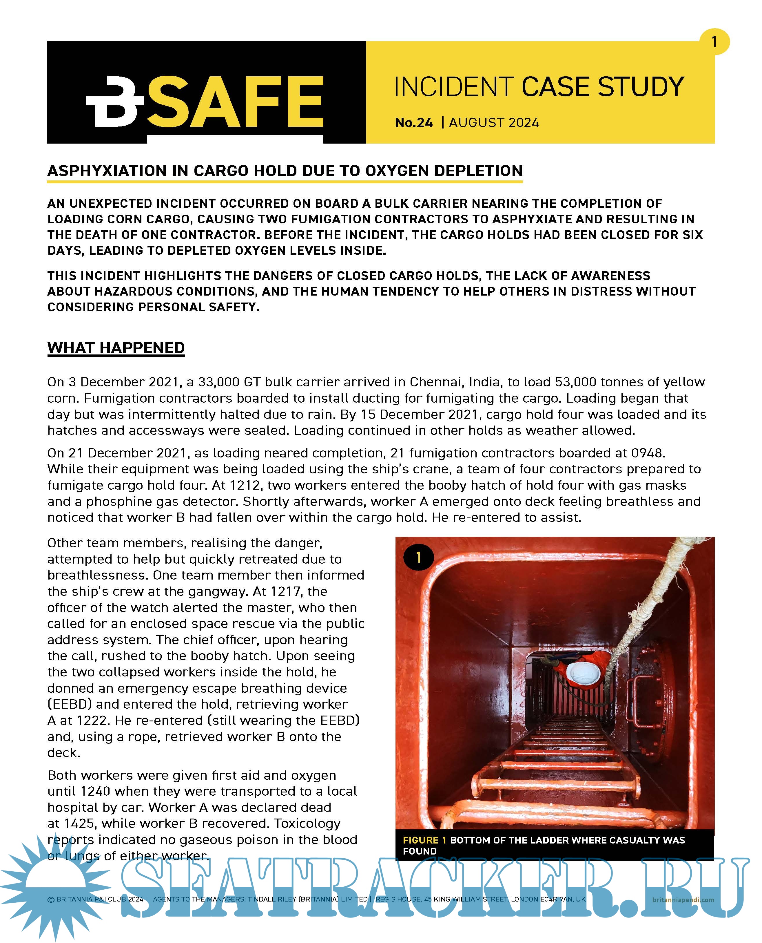

An unexpected incident occurred on board a bulk carrier nearing the completion of loading corn cargo, causing two fumigation contractors to asphyxiate and resulting in the death of one contractor. before the incident, the cargo holds had been closed for six days, leading to depleted oxygen levels inside. this incident highlights the dangers of closed cargo holds, the lack of awareness about hazardous conditions, and the human tendency to help others in distress without considering personal safety.
