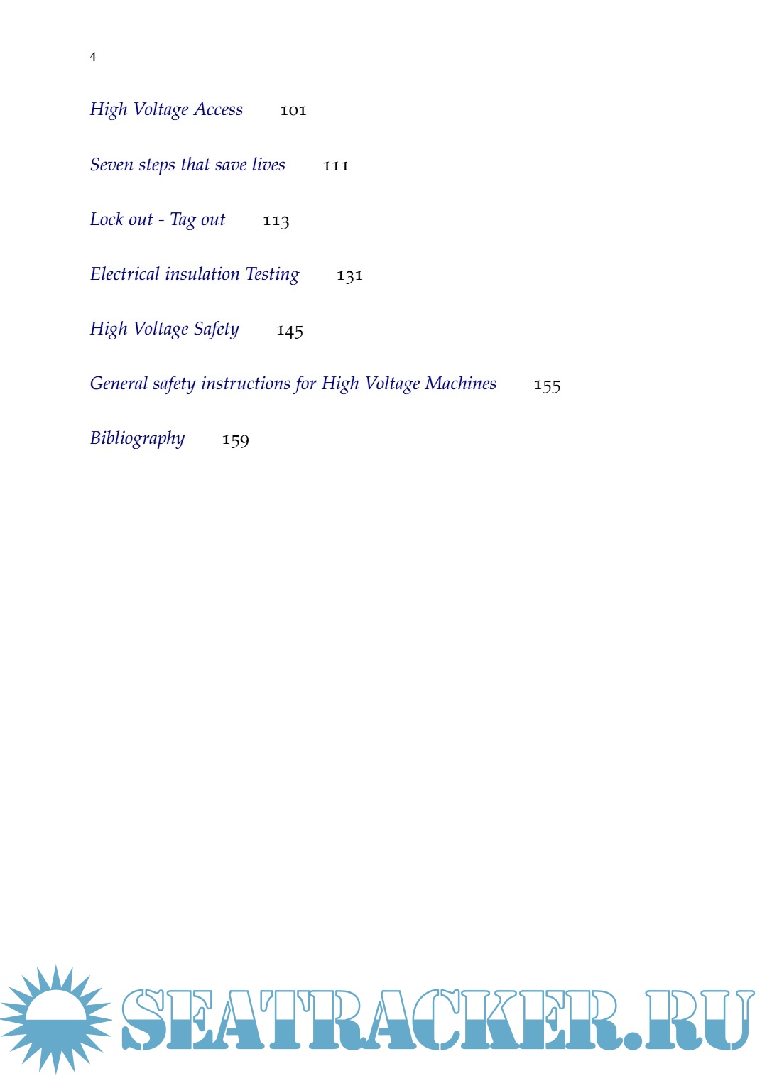

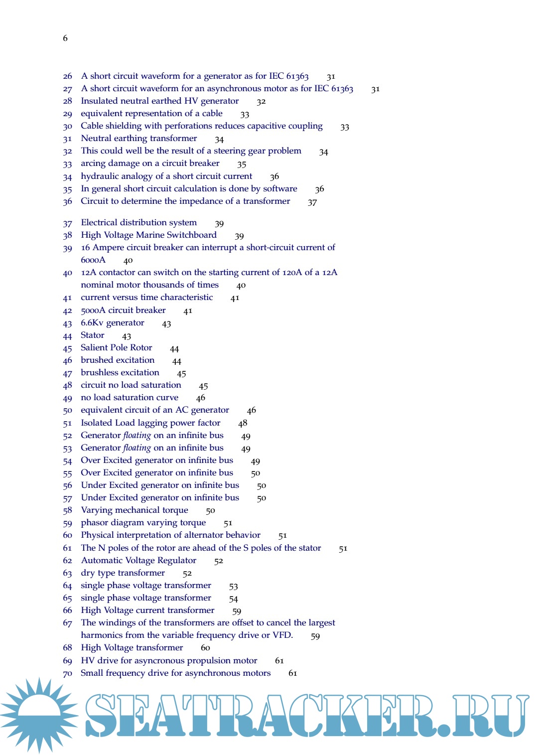

High Voltage Safety
Year: 20XX
Author: Antwerp Maritime Academy
Genre: Guide
Publisher: Antwerp Maritime Academy
Pages count: 159
