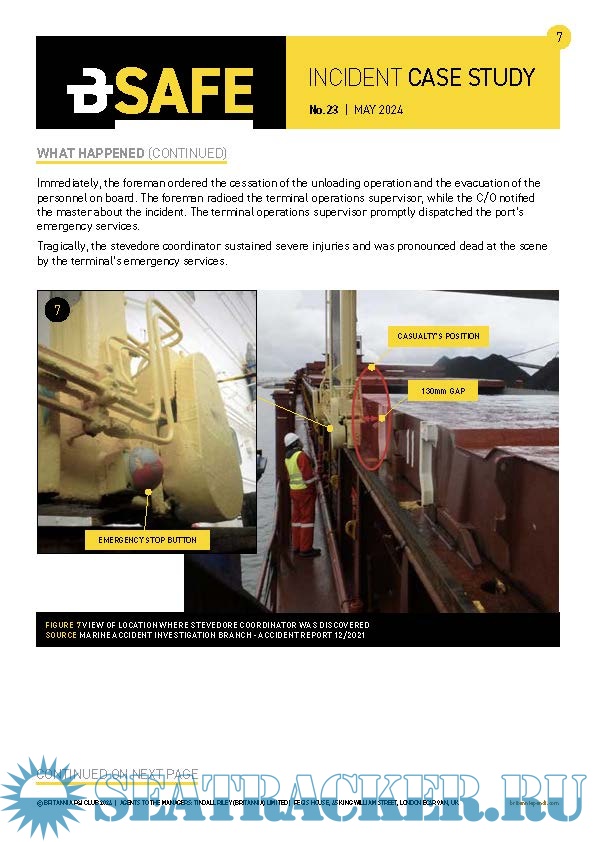

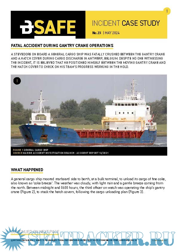

A stevedore on board a general cargo ship was fatally crushed between the gantry crane and a hatch cover during cargo discharge in antwerp, belgium. despite no one witnessing the incident, it is believed that he positioned himself between the moving gantry crane and the hatch cover to check on his team’s progress working in the hold.
