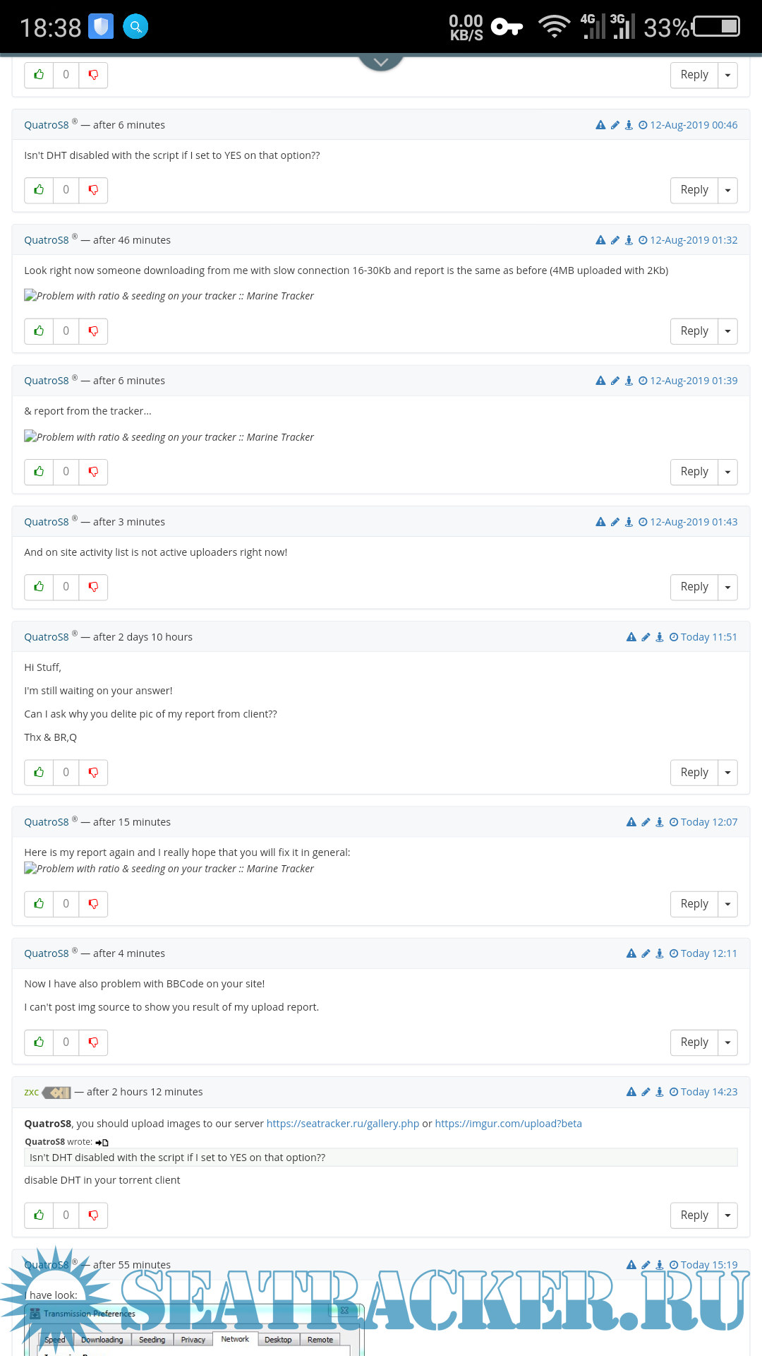

Can you please help me to fix my problem with upload speed & seeding report on your site?!
I can see that users from your site download from my sources but your tracker don't record everything! For one example is my last download "Thomas Stowage - Captain G.M. Pepper [2018, PDF]" where I seed more then 124Mb, but tracker record only 98Mb Плачет

Look right now someone downloading from me with slow connection 16-30Kb and report is the same as before (4MB uploaded with 2Kb)

Can I ask why you delite pic of my report from client??
Thx & BR,Q
QuatroS8 ®   14-Aug-2019 12:11
Now I have also problem with BBCode on your site!
I can't post img source to show you result of my upload report.

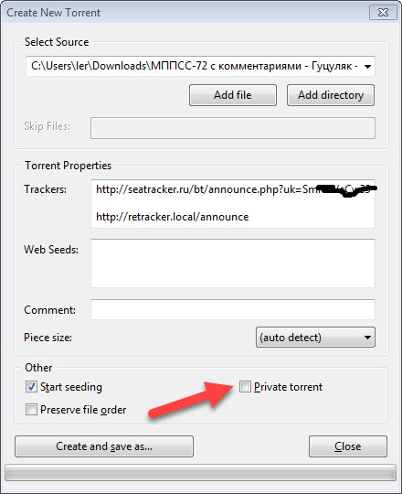

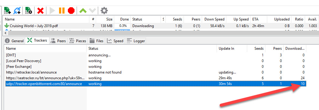

QuatroS8, provide me some screenshots to analyze data. Leakage of traffic - its normal for our tracker. If you want to prevent it try to create torrent with PRIVATE flag
As you can see we use openbittorent which help us with seeding. Your file was downloaded 10 times bypassing the seatracker.
Our tracker does not take into account traffic passed through DHT or openbittorent
use PRIVATE flag to disable openbittorent

zxc it is not problem what or who is downloading from my sources, but in my ratio which remains all the time on zero (please look again image above)!
If I upload a magazine whose size is 145,3Mb x 7 times (in total this means more then 1Gb of data), I expect fair record of may ratio from your tracker!
