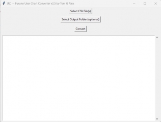

How to Use
How to use

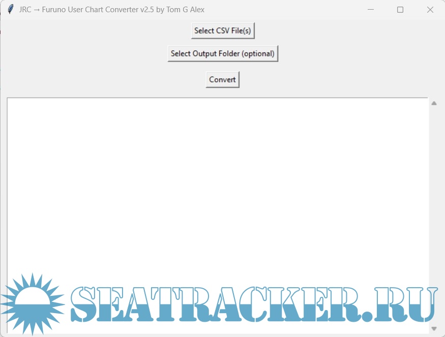

Double-click JRC CSV to Furuno XML Converter.exe
Click “Select CSV File(s)”
Choose one or more JRC User Map .csv files
(Optional) Click “Select Output Folder”
If not selected, output will be saved in the same folder as the CSV

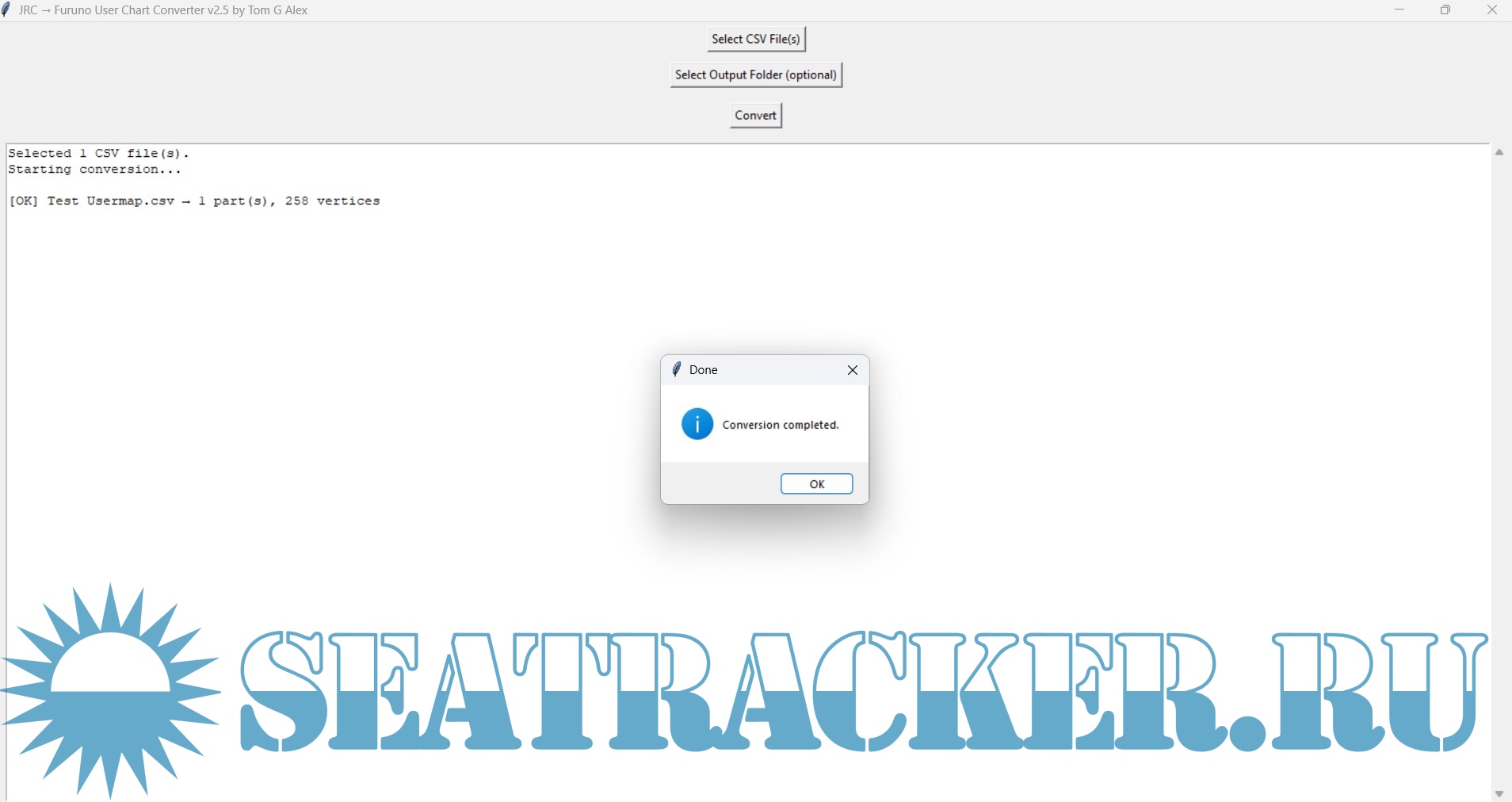

Click “Convert”
Wait for the message “Conversion completed”
That’s it.

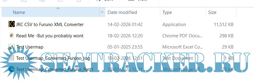

For each CSV file, the program will create:
One or more
*_Converted_Furuno_PartX.xml files

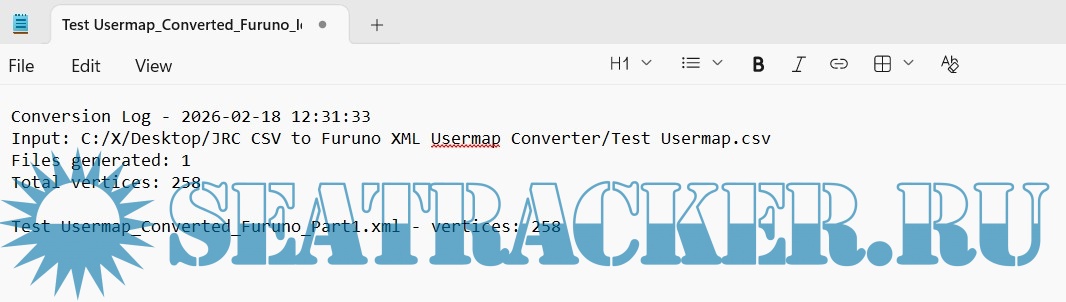

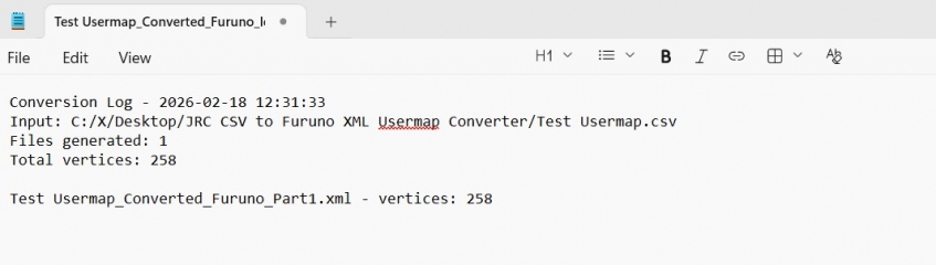

A conversion log:
*_Converted_Furuno_log.txt
(If applicable) a skipped lines log:
*_SkippedLines_log.txt
