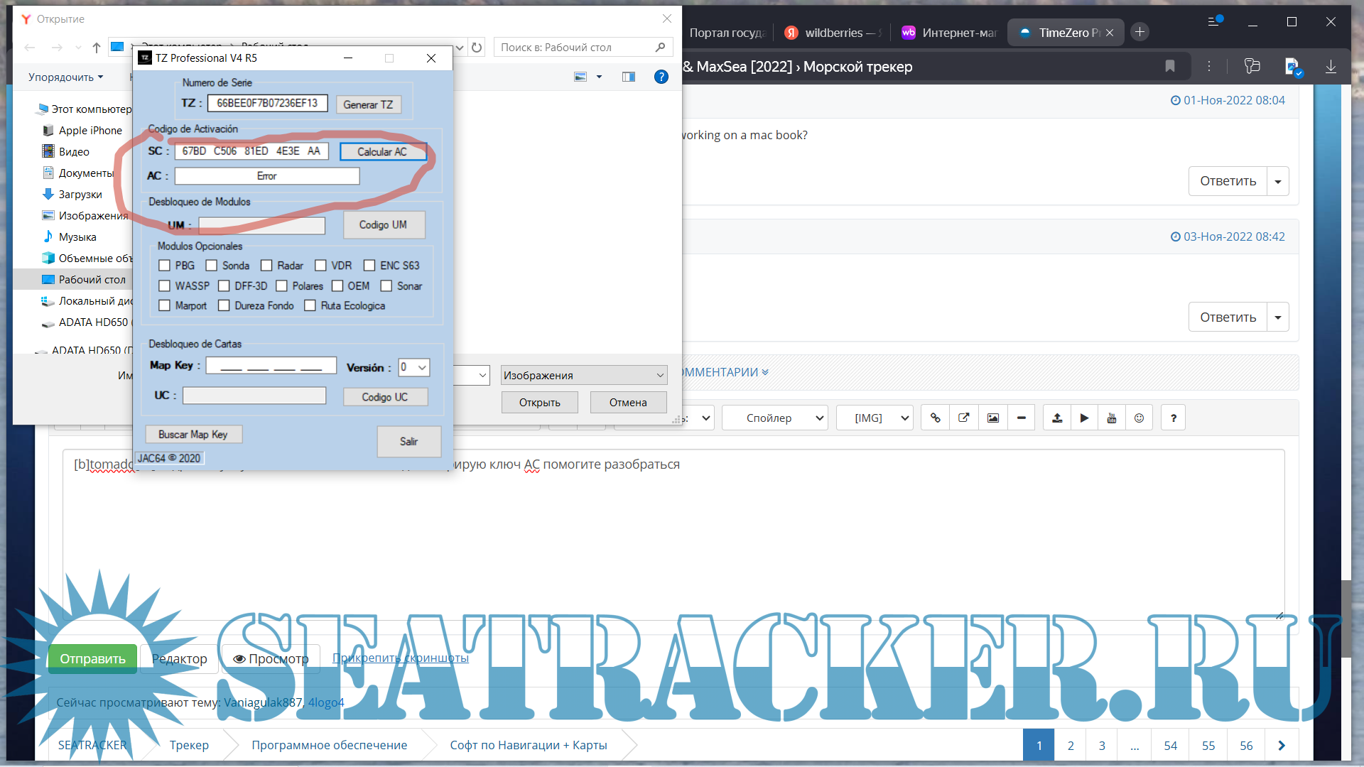

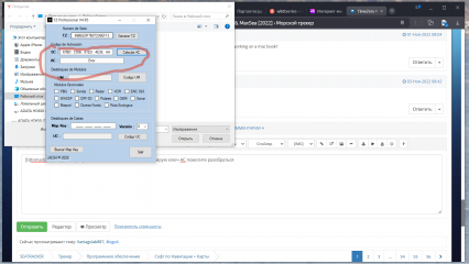

Vaniagulak887   23-May-2025 15:22
tomado, Здравствуй у меня вылазит ошибка кода генерирую ключ AC помогите разобраться
matrixdu   23-May-2025 15:48
Vaniagulak887, If problems with activating TZ (error ac ) do thisdelete license file at C:\Program Data\CrypKey\Licenses folder and , also you need to delete serial_number file at folder C:\ProgramData\TimeZero\MetaCatalogWhen you are done with that begin with all the activation process againoruninstall TZ v4delete C:\ProgramData\CrypKey\Licensesdelete C:\ProgramData\TimeZeroRESTART computerkill process crp32002.ngn if runningreinstall TZ V4.1.0.53 with a new serial numberor1 - close Timezero2 - open task manager and kill all the task running named crp320002.ngn3 - delete folder C:\ProgramData\CrypKey\Licenses4 - remove the serial number file in programdata/timezero/metacatalog5 - Deactivate your internet connection6 - launch again Τimezero and try again the activation.7 - reactivate TZ with a new serial number and you should be back in business.
