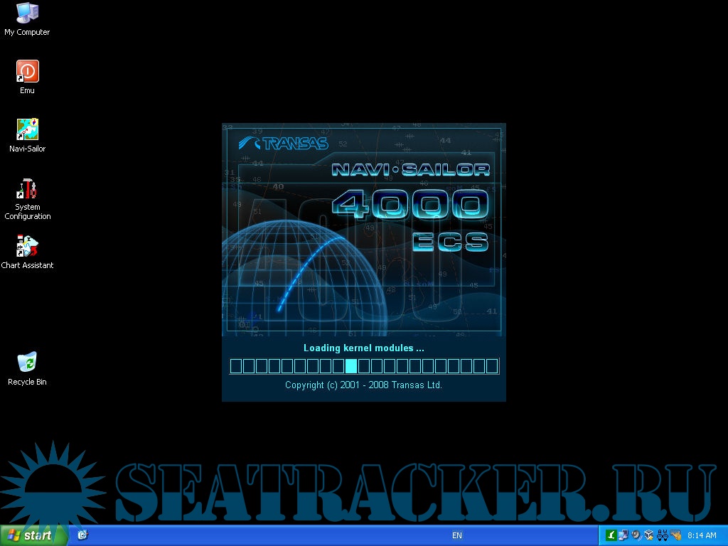

For those getting Sailor.exe Error, Im Getting it also but i got some solution
1. Download The Latest Oracle Virtual Box. Im Using 6.0.4 & Install
2. Download The corresponding oracle extension pack 6.0.4 same version as your virtual box
3. After you setup your virtual box using the file given by arcan, go to devices tab and click insert guest addition cd image and follow the instructions
4. Change the Year Date into 2006 or less
5. start Emu all the time
6.change the resolution of the guest Xp in to maximum by Desktop Properties
I Hope i help you guys having some problems.

37778Установил, при запуске пишет, sailor.exe has encountered the problem, закрывается.
Как решить?
Вдруг кому-то пригодится.
Эта ошибка возникает в случае, когда у вас установлено нестандартное разрешение экрана, что свойственно виртуальным машинам.
Ставьте в виртуалке 1024х768, и будет всё ок.

Second, i had some troubles getting the Navi-Sailor up and running through Virtual Box, BUT after redownloading the torrent once more, i got it up and running in a WinXP 32-bit Virtual Machine. But ofcourse not without more problems. The next thing was that the ChartAssistant made an error when trying to execute. This error is not so bad. What's wrong is that your Virtual machines date/time is updated automatically and to change it in windows XP - without it changing to present time and date - what you need to do is open up CmdPrompt from your Virtual Box filelocation, so it looks like this;
C:\Program Files\Oracle\VirtualBox>
and then you type;
VBoxManage setextradata "VM name" "VBoxInternal/Devices/VMMDev/0/Config/GetHostTimeDisabled" 1.
Where "VM name" should be the name of your virtual harddisk, for example "navisailor 4000 xp".
Then you go to your virtual machine, run it and change the time to something like december, 2008.
I hope this helps, even though it's a bit outdated the whole thing.
