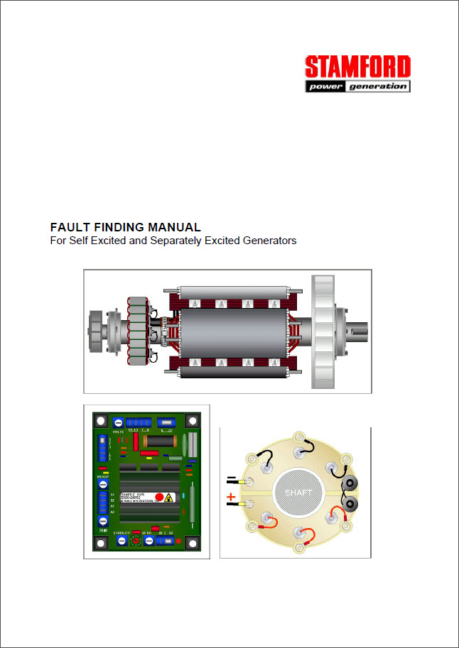

Руководство по поиску неисправностей в генераторах с самовозбуждением и незавысимым возбуждением / FAULT FINDING MANUAL For Self Excited and Separately Excited Generators
Year: 2010
Author: STAMFORD Power Generation
Genre: MANUAL
Publisher: STAMFORD Power Generation
Quality: OCR without errors
Number of pages: 29
Description:

CONTENTS
SECTION 1
Recommended Metering and Test Instruments
SECTION 2
Electrical Terminology
SECTION 3
Fault Finding method ‘A’, for All Generators SECTION 4
Fault Finding method ‘B’, for Self-Excited Generators.
Automatic Voltage Regulator is powered from the Generator Output.
SECTION 5
Fault Finding method ‘B’, for Separately Excited Generators
Automatic Voltage Regulator is powered from the Permanent Magnet Generator.
SECTION 6
Parallel Operation and Fault Finding for All Generators
